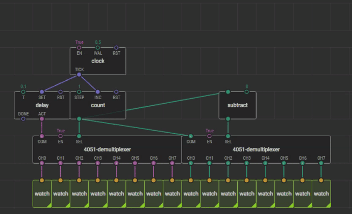

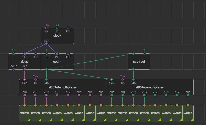

Hi, in this library there are nodes, which can be useful. For example 4051-demultiplexer.
cesars/4051
Maybe do you know what node of that library would fit me best?
use SEL to choose the output
also this cesars/4017, it’s just a decade counter , but maybe I’ll add something so it can be used generically
Update the library, this had an error that did not erase the outputs, now it works correctly
