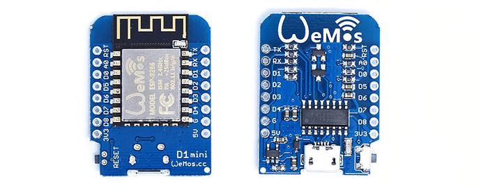

Hello, can not operate the Wemos, the programming is loaded but the LED does not blink.
I have selected D4, with IDE Arduino works.
Try several of the list, in all load the program but it does not work

It’s a little disappointing, but in XOD port literals with D
char converts in just a port number (D4
-> 4
So when you define D4
it really bound to the hardware D2
, when you define D13
it bound to the hardware D7
and etc.
So let’s check this scheme: https://things4u.github.io/HardwareGuide/Single-Channel-Gway/images/d1-mini-esp8266-board-sh_fixled.jpg and define ports with number from “Arduino” block.
If you want to blink with hardware D4
define it as D17
in XOD IDE.
Try it and tell me if it helps.

Returning to the problem with the led, try to connect your LED into D7
port on the Wemos and define it as D13
in XOD IDE. Do not forget to connect it to the G
round
no work , if in IDE-Arduino takes it as “digital channel 2” works
PD: after programming with Arduino IDE, I went back to XOD and … wow is working with D2
