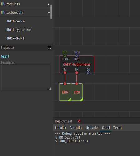

I have a dht11-hygrometer and I installed the library for it xod-dev/dht I have an UNO and the dht11 output pin is connected to pin 10, + to 5v and - to gnd. When I upload to the UNO I get the following message
=== Debug session started ===
RR:523:7:31
XOD_ERR:121:7:31 code
I have two watch nodes attached one to Tc and one to RH they will flash between ERR and very briefly a number Tc 25.0 and RH 34 which I interpret are the Temp and humidity respectively temp is in C.
The dht11-hygrometer node perimeter box turns red and the text in the watch nodes is also red.

Some sensors need time to recover between checks you could try connecting clock to the UPD pin to update every second instead of setting it to loop.
when I added the clock it would alternate flashing with ERR and the dht node boarder in red for 1 second and then white with the actual temp and RH for 1 second. clock IVAL is 1.
I placed the sensor in my hand and then the ERR stopped and the readings changed. Then I put the sensor down and after a bit the ERR began again.
I added a count node and linked it to the clock node with a watch. changed the clock IVAL to 10 and NO ERR. In my mixing station I want to record the outside temp & RH every time a batch is made. I also want to record the temp & RH every 15 minutes, this will give me an idea of how much solution is being consumed by the plants during various times of the day.
