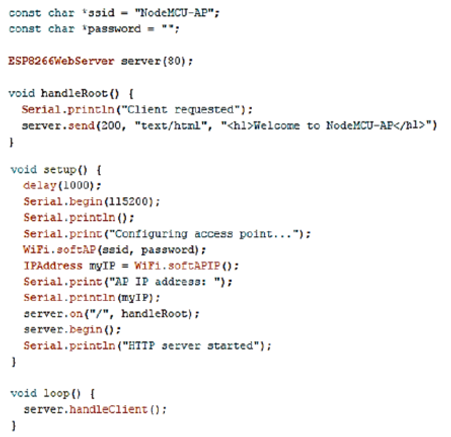

I’m in a learning process to create a node for the above purpose. In case anyone can help us to create a node that can handle a way to activate the web server in the board, it will be very great, we can manipulate our sensors through web service (browser). I’m thinking of converting/modifying the following C++ code to become a XOD node:
My skill is not strong enough to do this. I really appreaciate any help.
I was trying to write something based on another example… it is not working yet… in case someone can help me to understand it better…

For now I just want to make the device can perform as an AP webserver.
I’m not sure your first point of deleting SSID & password, since my intention is just to activate the AP mode (standalone WiFi mode).
I changed as follow, but the errors are still there:
The compiler indicate the error/bugs are at line 36 & 43:

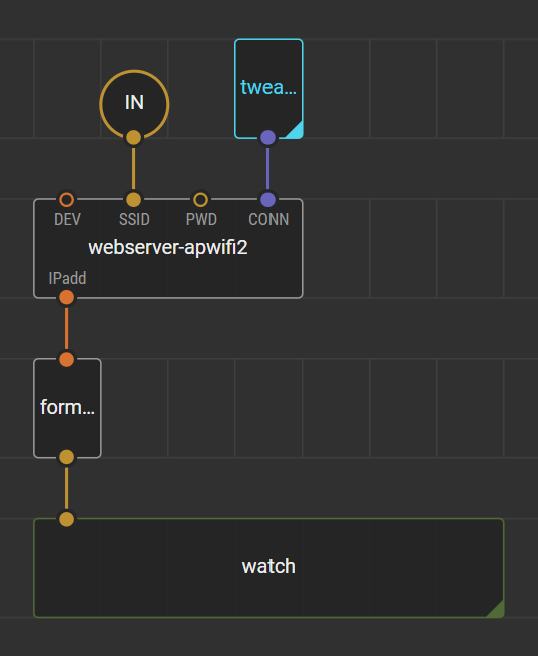

I “resolved” the problem of string conversion by outputting/emitValue as an IPAddress datatype (and link it to output-ip-address node) [Lines 47 & 48]. However the IP address is not displayed yet, the bug has gone for the time being.
Now, I’m trying to create a node to activate the webserver in nodemcu 8266 with Wifi mode. I will use connect node from xod-dev/esp8266-mcu/connect. The following code is the ref C++ I intend to use:

I plan to do something like this:
and this is my converted code:
