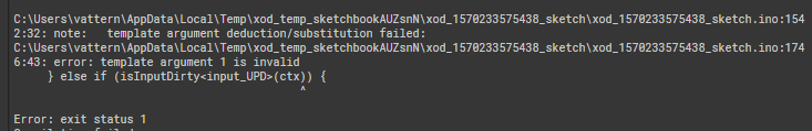

I just tried to go through the "welcome to xod- chapter "207-busses"without any changes and get the following error-message:
Don’t know what to do, seems version 0.31.0. has some issues?
pls help me…

It is caused by some “error” implementation in defer node
place two defer and it will work, I think this is an issue

what do you mean by “place two defer”? two defer after another does not work.
sorry the work around you showed functions.

The fix is released. Please update to 0.31.1
Thx for the quick response, my tests have been positive now.
