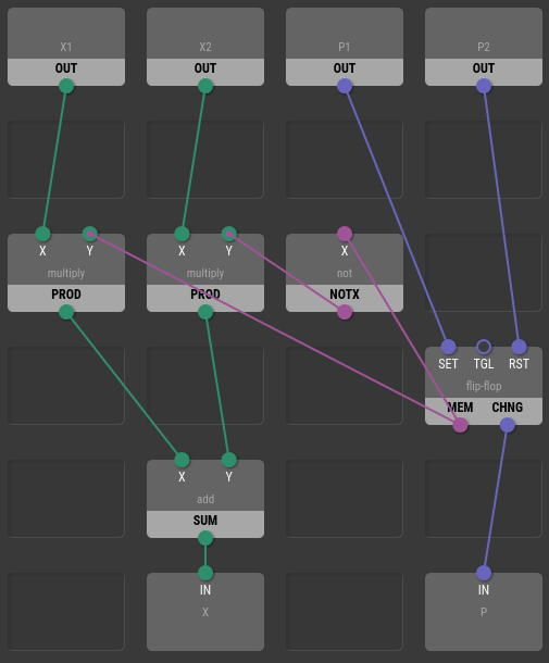

It could be done with something like:
Yes, there is a counter node that is not in the standard library although it is a good candidate for it. Meanwhile I could implement it in XOD:
What is select? Another good candidate for stdlib. Meanwhile:
