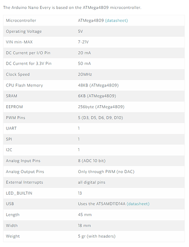

Hi, @dnl. What is your board? Exactly. Name, spec, etc.
Hey, @gabbapeople. Unsure if it is what you’re looking for but I took it from the tech specs on the Arduino website:
Datasheet links:
Microcontroller
USB
