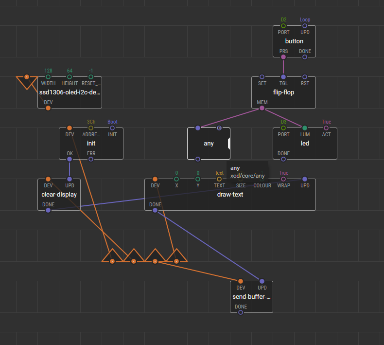

unfortunately it doesn’t work, maybe something else should be added instead of concat?
how do i have to connect it to be text when the diode is on and without text when the diode is off …
Mmmmm maybe try getting rid of the concat and placing the gate in between the done on of the draw-text node and the upd pin on the send to buffer node? I’m not sure lol I just trying to guess on what can work at the moment. It would be cool if the if-else node worked with texts as well
Is the text showing up with the diode on?
use “any” and when the LED goes out clear the display
or is there some simpler way?
Where to connect the any node depends on what you are trying to pulse when the LED comes on. The any node is for joining multiple pulses. You don’t need the any node if there is only one input being used.
Are you trying to update text when the LED comes on AND after you clear the display on boot? If that is your goal, then clear-display-DONE should go to the other any input and any output should link to the draw-text-UPD pin. If you want to update the text when LED comes on AND when it goes off, you will need a pulse-on-change between the flip-flop and the any node.
FYI: bus nodes (the triangles) only exist to clean up the program layout so wires aren’t running across the screen. If you are not going to place them where they are being used, you may as well just run wires directly without the bus nodes. You can run multiple wires out of the from-bus, so you may not need so many of them – whatever makes it look best/cleanest.
thanks, i just wanna show when the LED is on the screen it says “LED on” and when the LED is off to write “LED off” in the simplest possible way …
