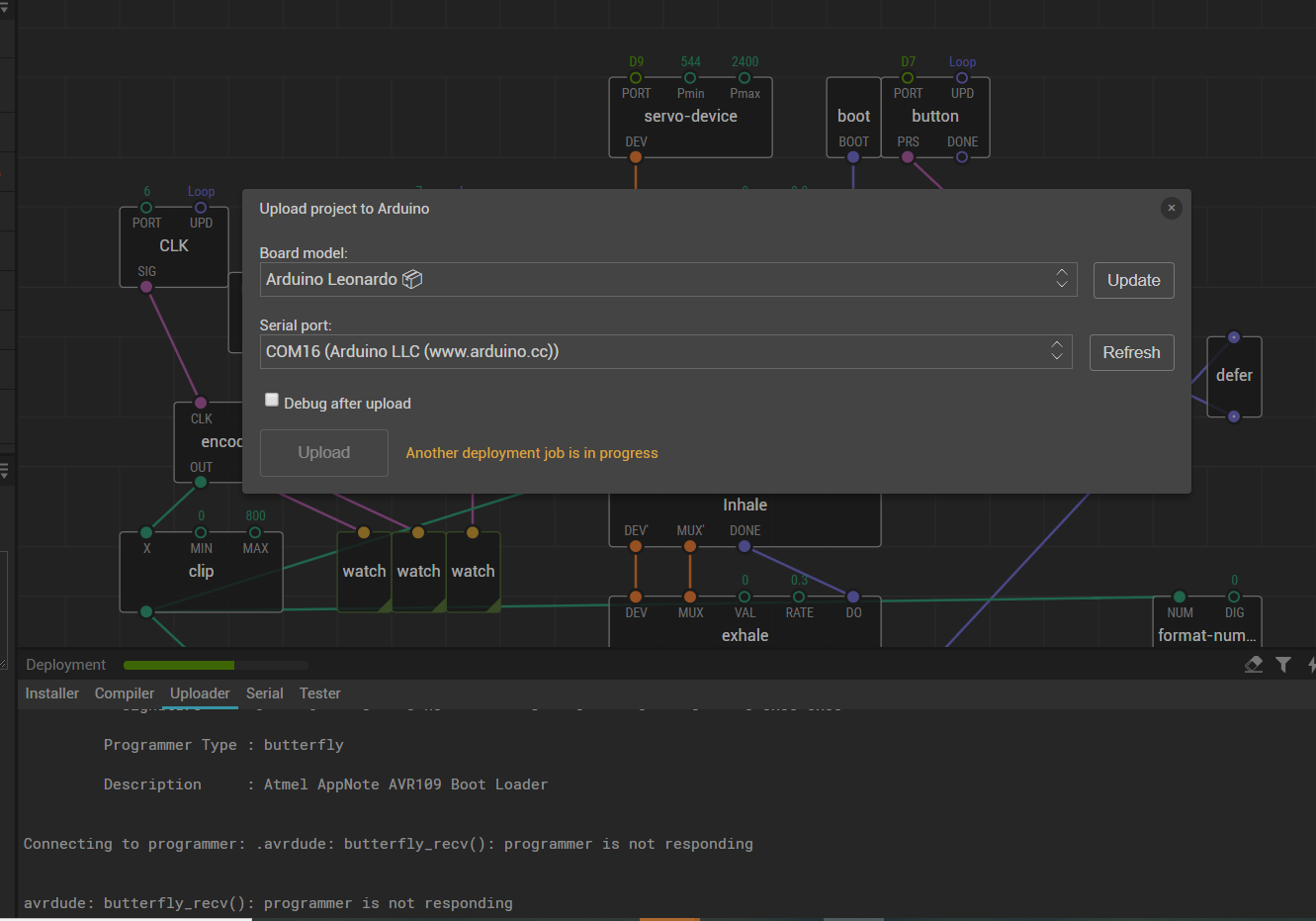

We did not make any change before the update and the project running successfully after the update we face major problems
Oure project cannot upload to the Arduino after update to the last version
We are using (show code for Arduino) to upload the code
Our servo not working correctly and hi vibration
Cannot show the live connection and cannot complete the code uploading to the Arduino board
We can’t watch any live value from the rotary encoder watch node
If we use non XOD code with Arduino ide it will works correctly
Please any guidance or support will be appreciated
Thanks a lot in advance
XOD ide stooped at this step !!!

after some editing its work but i cant upload the code from XOD IDE only from Arduino (show code) here is the error picture and also i cant see live feed from rotary encoder numbers

Sorry, my mistake. I thought I saw a reference to the WEB IDE in one of your posts. I’m not sure what the issue is. Unfortunately I don’t have a rotary encoder or Leonardo board, so I can’t do much testing. I was able to upload your patch to an Arduino Uno using the XOD IDE.
I saw on another thread (Error on Leonardo deployment) that someone encountered a similar issue when using a leonardo board and it seemed to relate to a faulty USB port on their PC.
i get this error
avrdude: butterfly_recv(): programmer is not responding
The attached xodball correctly uploads on my Arduino Uno on the latest version of the XOD IDE.
Moreover, this error “programmer is not responding” tells that there is a problem with the microcontroller and it is not responding.
It might be one of these problems:
- The bootloader is corrupted and you need to burn the bootloader. If you can upload any other sketch from the Arduino IDE and it works on the same MCU, it is not these problem.
- You selected a wrong port in the Upload popup.
- Some issues with the USB port, try to use USB hub.
Also, you can try to upgrade Arduino packages and toolchains (In main menu: Deploy -> Upgrade Arduino packages & toolchains). Or switch the workspace to the new one and install the packages and toolchains again.
