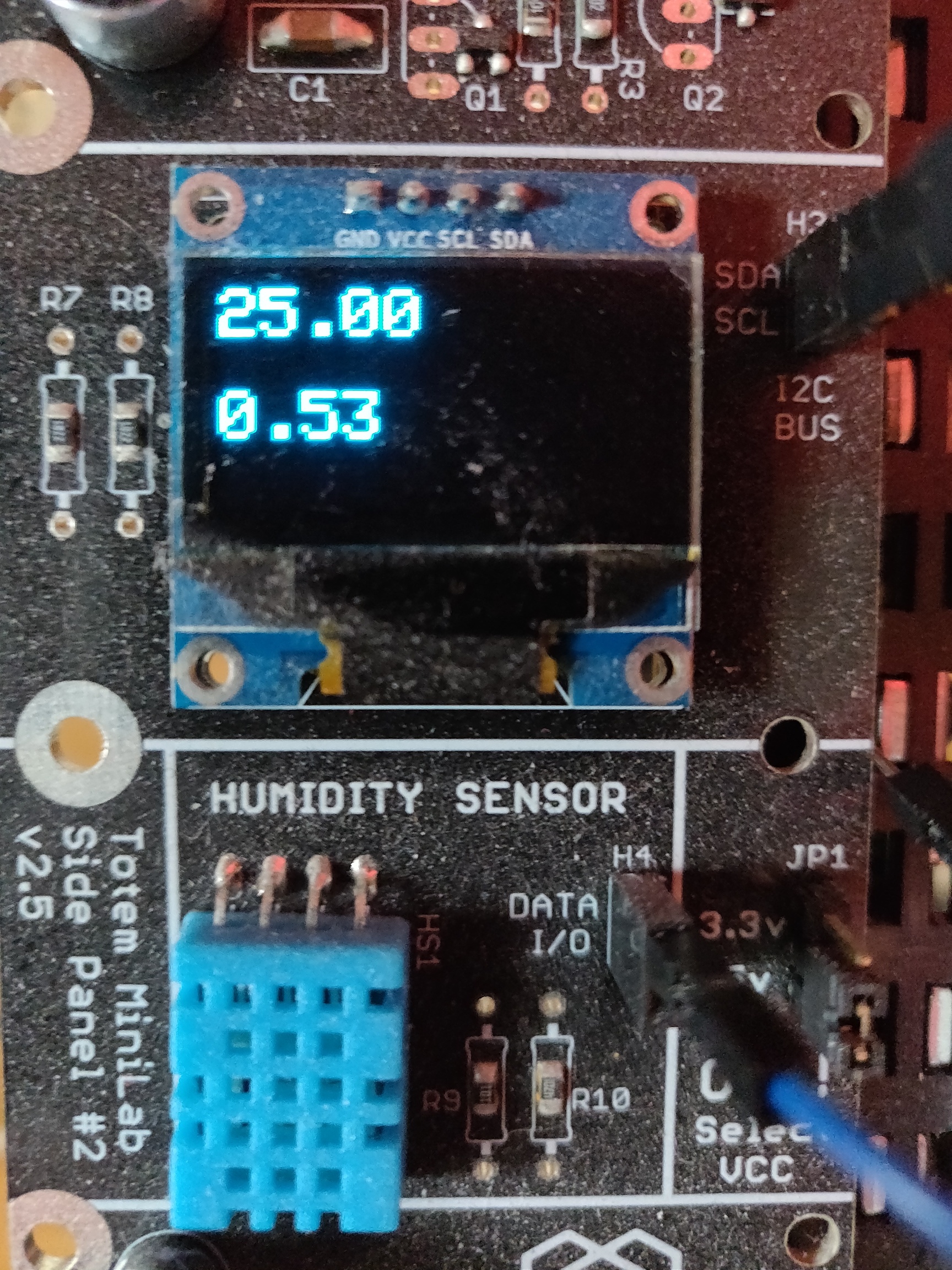

I don’t have a DHT22, so I haven’t been able to replicate your problem. However, I can display both temperature and RH outputs from a DHT11 on an OLED:

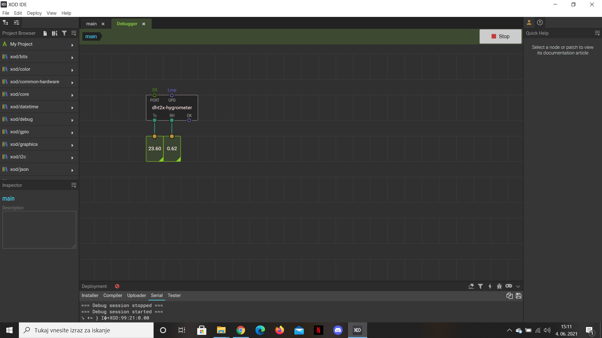

Have you checked that you get both RH and temperature readings from your sensor? You could test your sensor using a patch with only the dht2x-hygrometer node and a couple of watch nodes:
I have a 0.38.0 version, i tried to do it with watch nodes. For split second it shows the value, the onther split is error blink.
I’ve no experience of using the DHT22, but I wonder if it is being sampled too frequently? Maybe try reducing the sample rate to 0.5 Hz:
I have did reduce sample rate and if i try watch node, it does not show error anymore. But still, if i want to display to two normal words like “hello world” it works, if i want to display two values from dht22 it does not (black screen). If i connect just one value it works.
