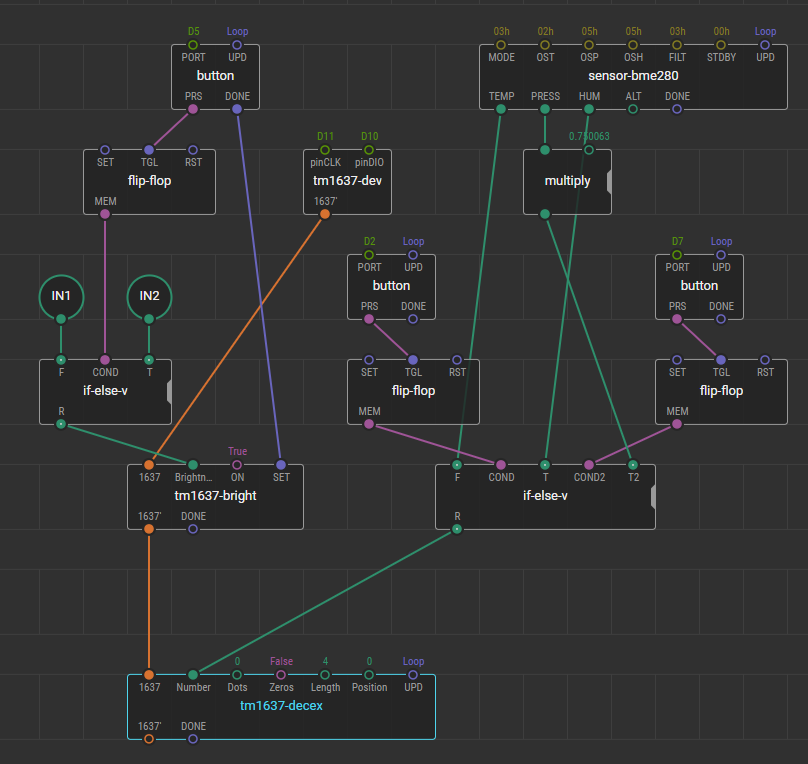

Hello everyone! I cannot find a nod that would allow using one button to alternately display more than two values (in my case 3). if-else-v still has to use the second button. and is it possible to add a symbol only after the temperature value? can you help?
Button increments counter to change nth-input selection. ‘greater’ resets counter when it goes beyond that last input.
Concat can be used to add text to a value. I’m not sure how to get degree symbol, though. If you are using Windows, you can hold the alt key down, type 167, then release the alt key.
