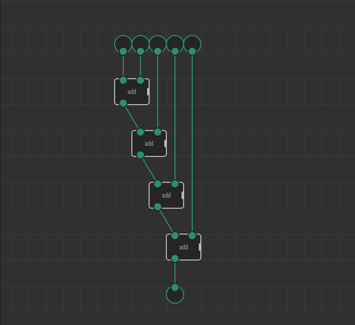

Minor issue: on the page https://xod.io/docs/guide/creating-variadics/, A4 is also an accumulator pin.
Thank you. The fix is on the way.
