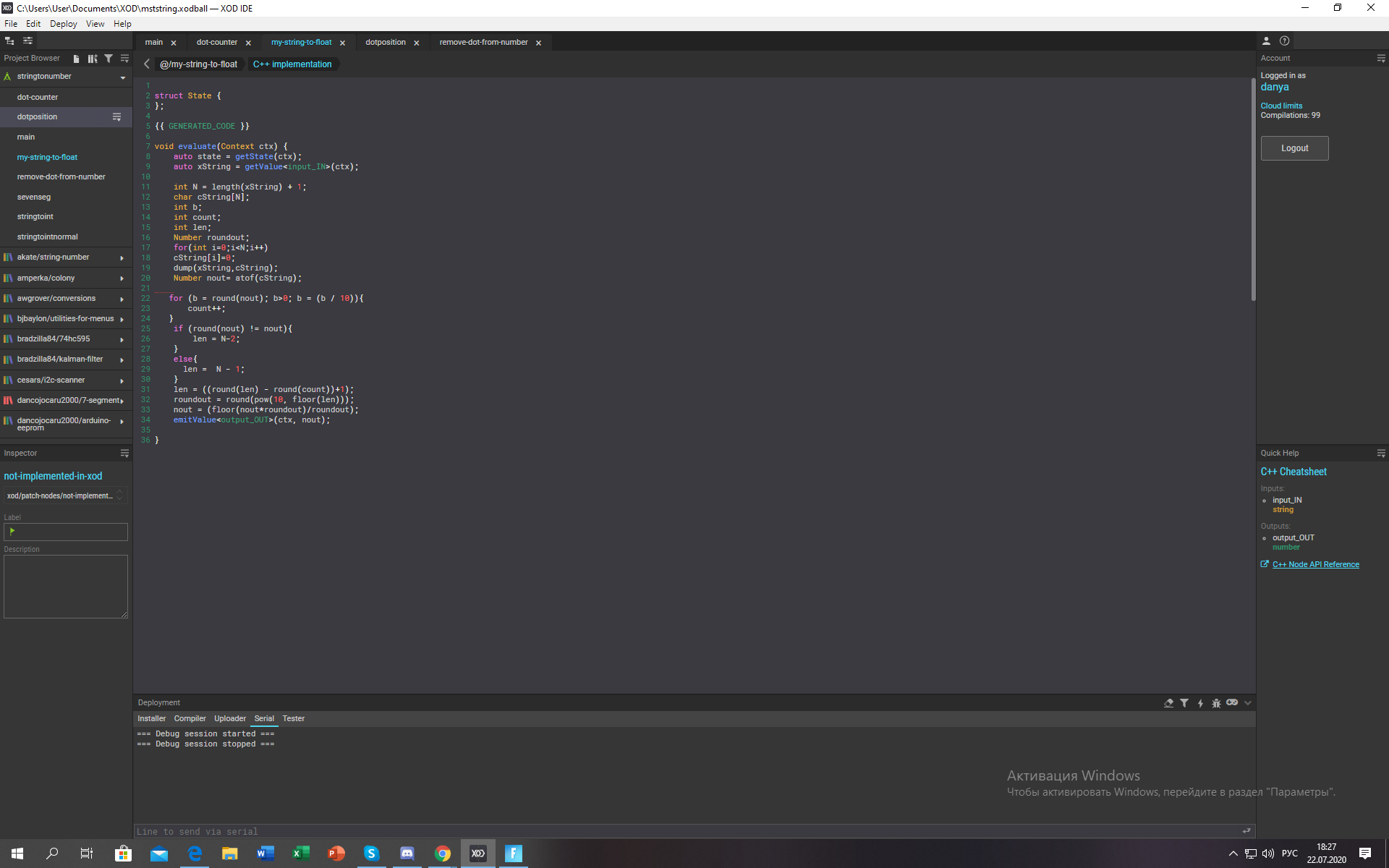

I decided (tried) to solve this problem myself. It also seems to me that the watch is not working correctly. Well, here’s my string to number:
struct State {
{{ GENERATED_CODE }}
void evaluate(Context ctx) {
auto state = getState(ctx);
auto xString = getValue<input_IN>(ctx);
int N = length(xString) + 1;
char cString[N];
int b;
int count;
int len;
Number roundout;
for(int i=0;i<N;i++)
cString[i]=0;
dump(xString,cString);
Number nout= atof(cString);
for (b = round(nout); b>0; b = (b / 10)){
count++;
if (round(nout) != nout){
len = N-2;
else{
len = N - 1;
len = ((round(len) - round(count))+1);
roundout = round(pow(10, floor(len)));
nout = (floor(nout*roundout)/roundout);
emitValue<output_OUT>(ctx, nout);
The meaning is the same, but I tried to round the output number.
Just above I showed a photo where the watch showed 3, not 2. And now it shows correctly.
found an error in calculating count ++
replace round to floor:
for (b = floor(nout); b>0; b = (b / 10)){
count++;
and also in nout(34 line) replace the floor to round:
nout = (round(nout*roundout)/roundout);
