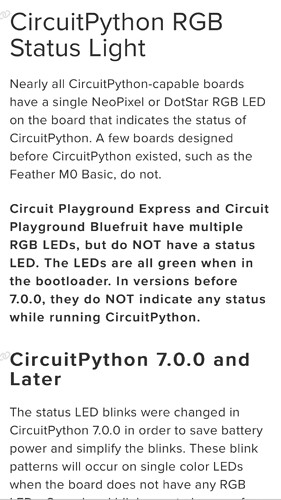

I am a little irritated of the rgb indicator light on the ItsyBitsy M0 Expres.
Is Ther a way to dim or turn it of?

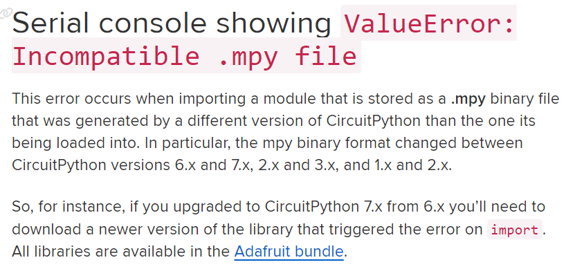

The led is stedy purple. This indicates a “ValueError”. Why?
